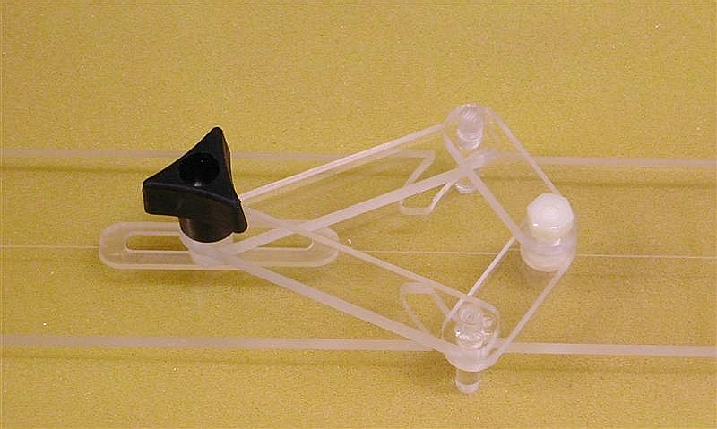

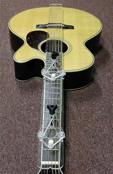

I just wanted to give everyone an update on the Simple CenterLine Finder. We have updated it to work with tapered fretboards by making some minor changes. Unfortunately, we are not able to retrofit it to the original design. We will start shipping this week for the orders that were placed 2 weeks ago, but we do not have enough material to start taking on new orders. We should have some more available starting next week. Thanks for everyone on all the great suggestions, but I never had a chance to give my partner any suggestions on the fix, as he had already worked out the solution as soon as I told him there was a problem. Here are some pics of the new design:
Also, this new jig was tested at Michael Bashkin's shop(http://www.bashkinguitars.com)over the weekend. He had a neck that he was joining to the body, and this was an opportune time to have it tested thoroughly by an expert. We tested it using his manual method of finding the centerline, and using this jig. Both methods produced the same results. You can see pictures of the testing and the new jig HERE

Nice design now. That fixes the issue nicely.
I would still recommend some surgical tubing or other on those pins to keep from marring the finish...

Thanks Don! Actually, the plastic dowels are glass smooth, so it is almost impossible to mar the finish. I'm sure the guys who recieved the first jig can attest to this. My concern was that it should be able to stick to the side of the neck making it more stable, and that is why I want to add this tubing. I suggested this to my partner, and his reply was:
1. Surgical tubing is not the best material, as it breaks down very quickly, and cracks as it drys(it would only last about 6 months.) A silicon based tubing is much better as it does not break down. (My concern was the transferral of silicon to the wood and may cause finishing problems. He assured me that the silicon is baked in and non-transferrable)
2. Tried to find a good source of this material, and unable to find at this time.
So if we ever come up with a supplier of this material, we will add it to the jig. In the meantime, these dowels do the job great!

I suggested the tubing because it is softer than the plastic rods, and "just in case" the jig ever got nudged, the rods could dent the finish whereas the tubing probably would cushion it. Surgical tubing lasts a lot longer than that. I have some in use for over three years now. No signs of cracking etc.

I'm not sure we are talking about the same material. Maybe Andy can jump in let us know what he thinks since he works with this stuff a lot more than me. I'm just going by what my partner says. He wants to do it right, but we just need to find a good supplier. And Don, I know you are not trying to ride me, you do have the best intentions. But really, it is almost impossible to dent the finish with these rods. You would almost need super human strength to squeeze them together enough to dent the finish. Maybe some of the people that have received their jigs can attest to this. Anyone?

I agree that you can't easily dent the finish or the wood under "normal operating circumstances", but accidents happen, and a good lateral bump on the side of the jig can cause the dowels to dent the finish. That's where I'm coming from.
No I'm not trying to ride you! I think it's a fantastic jig, and I will be buying one myself, but I also know that I tend to be like the proverbial bull in a china closet when it comes to my finish. My gut tells me I'd rather have those rods gripping the neck with something slightly rubbery than hard.
I'll just put some tubing on mine when I get it...!
Your guy is correct about the silicone tubing being safe...

You can do what I do. I fit my neck long before I finish my guitar!!!!
Once it is set, I place the bridge in the exact spot, drill holes 1 and 6. and
mask off for finishing.
I guess for a new bridge or a reset it is more of an issue

I haven't seen the dowels to comment. I would think it would also depend
on the finish.
Hard cat urethane....softer french polish
